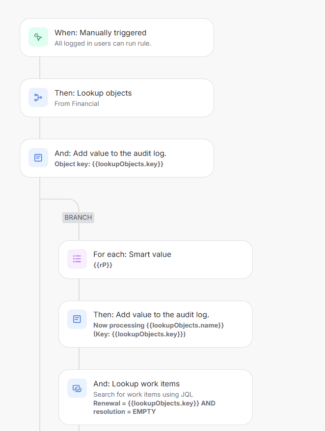

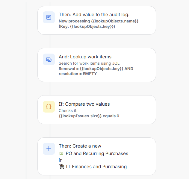

We're using assets to track recurring/annual payments. When the renewal date (asset attribute) is within 90 days, I want to create a ticket in our project. Currently, the date range is set for anything in the next 90 days in the AQL.
What works:
Scheduled Trigger - Branch on AQL - Create Issue
The Problem:
Creating duplicate tickets. I only need one reminder for each payment.
What I've Tried:

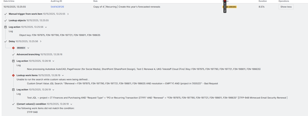

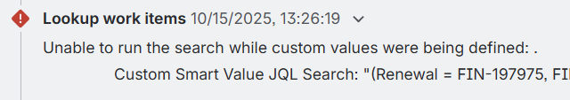

Various versions of the AQL search (branch and look-up objects), then lookup work issues, then compare lookup size. But the scope is not right/too big and I'm getting an "unable to run the search while custom values were being defined" error. Error and current testing iteration (with manual trigger) in screenshots. I get the same error if I schedule the automation or manual trigger.
The AQL search: objectTypeId = 932 AND "Status" != "Closed" AND "Next Payment Date" > now() AND "Next Payment Date" < now(90d)

Hi @Sara Rowe
To get it straight in my head, you need to find assets with a renewal date 90 days from now.
You are getting the right options, I assume.
What are the details of the branch step in your rule, are you processing each found object?
What i seem to miss is the work item lookup, what is the purpose of finding existing issues?
Also this JQL is failing, as it states that the field Renewal should be of type Assets, but this is not possible, you can't JQL on object key.
