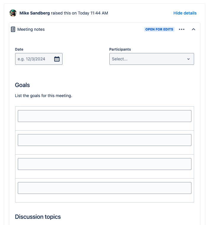

No, the form will be shown as part of the request, similar to this:
So the only thing you would need to include in the notification is the customer URL using the {{issue.url.customer}} smart value.
