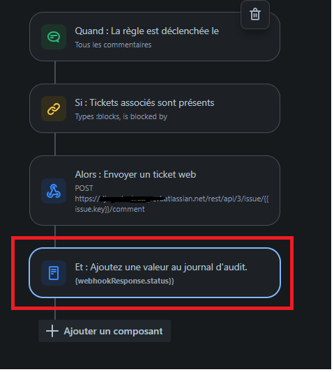

1 - My automation on js

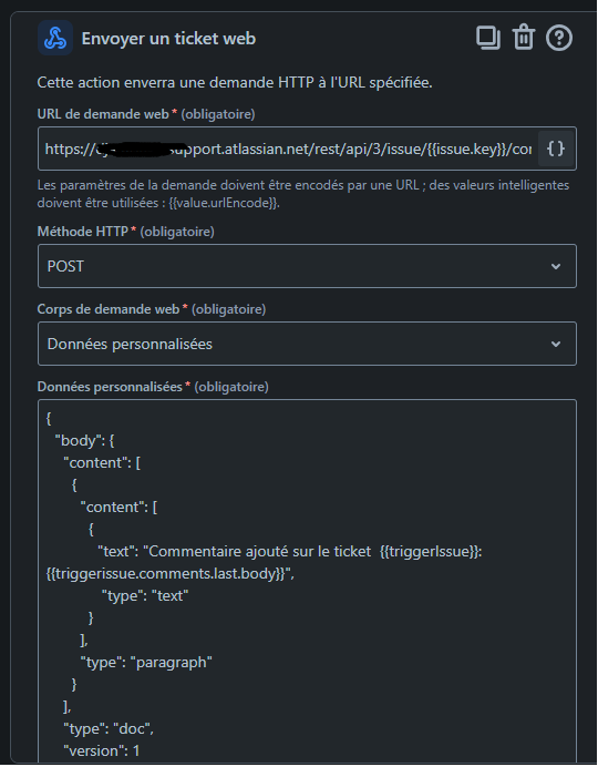

2 - In send web request, i put this
Webhook URL* : https://jsm.atlassian.net/rest/api/3/issue/{{issue.key}}/comment
HTTP Method : POST
Webhook body : Custom data
Custom data :
"body": { "content": [ { "content": [ { "text": "Commentaire ajouté sur le ticket : {{triggerIssue}}", "text": " Dernier commentaire : {{triggerissue.comments.last.body}}", "type": "text" } ], "type": "paragraph" } ], "type": "doc", "version": 1 }

After the web request is sent, be sure to check the 'Delay Further steps', add a log action step and print the Body and status of the web request sent.
This will help you identify if the comment is being added as expected.
So i add {webhookResponse.status}}
But, I don’t see any change in the logs
Add this syntax {{webResponse.status}} and retry the execution.

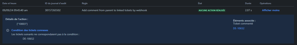

Can u share a snapshot of your web request action?

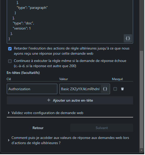

I would suggest making 2 changes
Firstly, check the second box as well so that the flow proceeds even without 200 response, this is for testing sake, and can be unchecked once you're confident the automation works fine.
Next I would Try using the Validate option, with one of the issue keys whose comment you're trying to copy. This will give you instant feedback if something is going wrong.

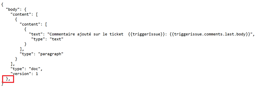

Got this error when using the validate option :
{ "errorMessages": [ "There was an error parsing JSON. Check that your request body is valid." ] }
My request body
"body": {
"content": [
"content": [
"text": "Comment added on ticket {{triggerIssue}}: {{triggerissue.comments.last.body}}",
"type": "text"
"type": "paragraph"
"type": "doc",
"version": 1
I solved the last error message by removing the coma here
