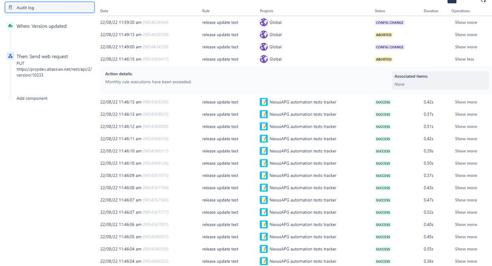

×Trying to synchronise versions between multiple projects using automation. Have already done create/release/unrelease actions successfully. But still I need to synchronise when release date or other property is update. I wanted to use Version updated rule, but it triggers each seconds, so I reach montly execution limit quickly.
Any ideas how to synchronise versions between projects other way?

Hi @Petr Novotný , could you share the config of your automation rule (trigger, condition, action) in a screenshot?
@Petr Novotný The log just shows how often the automation is running. Can you actually share the rules logic so we can see why it is running that often?
@Brant Schroeder Hi, u can see the logic on the picture's left side. There is just a Version updated trigger followed by Send web request action. For a while there was also Create variable action.
@Brant Schroeder That's what I don't know. I supposed it will trigger when someone go to edit version and confirm changes, as it works similar way for Create/Release/Unrelease version trigger, but it does not look so.
