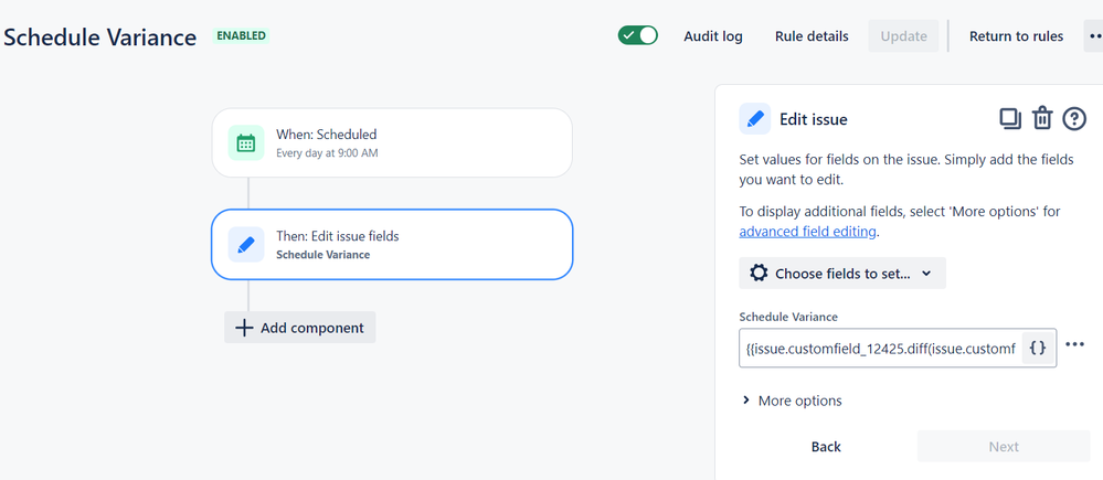

×i have created a rule to create schedule variance in Jira automation, the rule is executing perfectly but the answer is still 0.
i am using this formula,
{{issue.customfield_12425.diff(issue.customfield_11025).days.divide(issue.customfield_11025.diff(issue.customfield_11024).days)}}
please let me know where i am wrong.

You describe "the answer is still 0", and that is certainly possible for the expression you show.
To get a fractional value, a math expression may be used. For example:
{{#=}} {{issue.customfield_12425.diff(issue.customfield_11025).days}} / {{issue.customfield_11025.diff(issue.customfield_11024).days}} {{/}}
If you wanted that to a specific number of significant digits, you could add the ROUND() function, for example to 2 significant digits:
{{#=}} ROUND( {{issue.customfield_12425.diff(issue.customfield_11025).days}} / {{issue.customfield_11025.diff(issue.customfield_11024).days}}, 2) {{/}}

Hi Bill, Thanks a lot this expression worked and in future i will try to give a detailed description with screenshots.

All these custom fields are date picker field, i am trying to get value for (Actual End Date - Planned End Date)/(Planned End Date - Planned Start Date)
i am trying to capture the output of this formula in another custom field "Schedule Variance" which is a number field.
