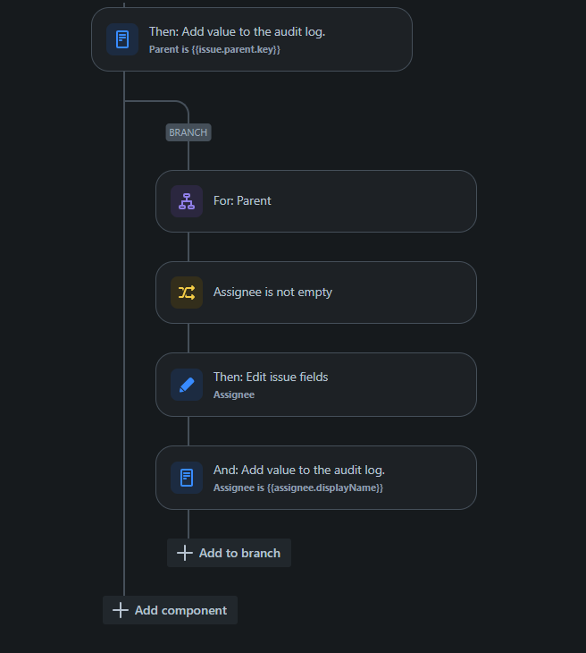

Hi! I've been trying to build a rule that would let me automatically copy the assignee from the parent issue. But it doesn't work, and for the life of me, I have no idea why. Currently, for testing purposes, I've built it so that the trigger is manual. ATSV3-1 is my parent issue, which has an assignee, and ATSV3-8 is the child issue, which has a parent and no assignee, that I'm trying to get to copy the assignee from the parent via automation. I'm running the rule from the ATSV3-8. I'm attaching a few screenshots. I'm using the cloud version of Jira Service Management. And yes, I'm using Edit issue fields action - Assignee > Copy from parent. Hope someone here can give me some guidance. Ty 2025-02-10_15h29_08.png 2025-02-10_15h29_19.png 2025-02-10_16h14_15.png

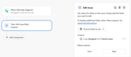

I may be misunderstanding here, but I don't see why you need the branch at all? In ATSV3-8, just use "edit issue field" that you have, pick the assignee value, and "Copy Assignee from Parent".
At the moment, it looks like your jumping into the parent ticket, and then editing that one?

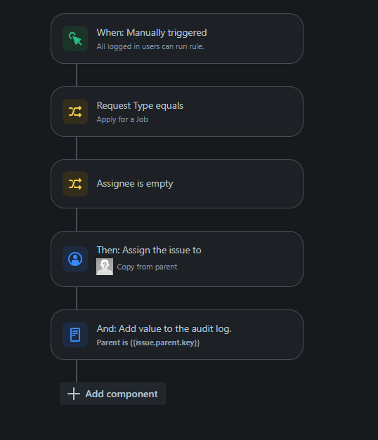

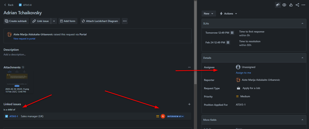

Hi Calvin, that makes sense. I tried something else already too, but that doesn't work either. It seems similar to what you suggest. Is there a reason why I can't use Assign the issue to and need to specifically use Edit issue fields? Because mine still doesn't work.
Aiste Marija Aidukaite-Urbanovic February 10, 2025 edited

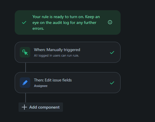

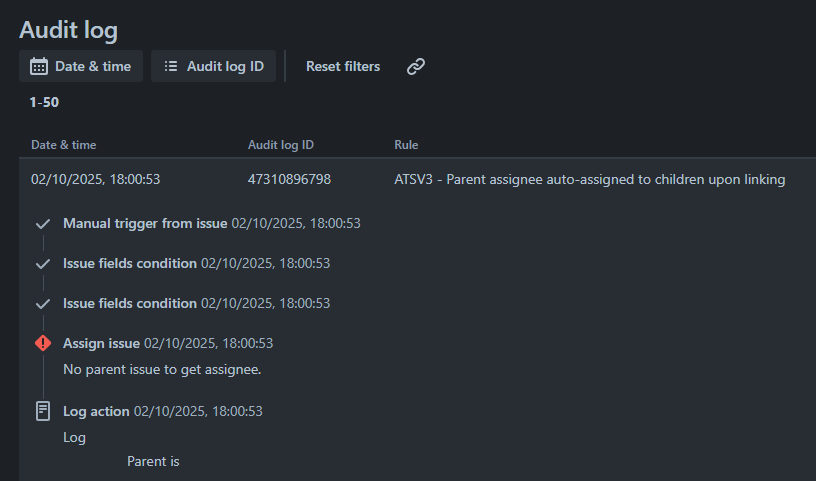

I have tried your recommendation, unfortunately doesn't work - any ideas what I'm doing incorrectly?
My trigger issue clearly has a parent issue, which in turn has an assignee. Still the error seems to be that it can't find an issue to copy from. I'm so lost at this point, this seems to be way harder than it should. That's the reason tbh why I tried branching.

Hi @Aiste Marija Aidukaite-Urbanovic , thanks for the screenshots above, they are great!
In your last image I see your "linked issue" with the link type "is a child of" that then links to another "task". This is actually a different type of link to a parent-child that Atlassian uses. Which is why this won't work.
Essentially Atlassian is able to use "subtasks" to split apart issues instead, in your image you can see how they are created just under your name where it shows "Create Subtask". You will also see this is connected completely different to the "linked issue" way that you have. This would allow you to use the "Assign from Parent".

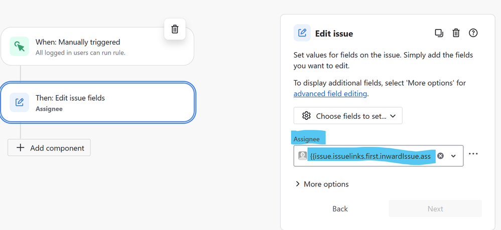

Have you tried the smart query in the link, by using assignee value as: {{issue.issuelinks.first.inwardIssue.assignee}}
Its probably the simplest solution though keep in mind this would take the first inwardlinkedissue, incase you have a task that has multiple links or you need an outward link: {{issue.issuelinks.first.outwardIssue.assignee}}

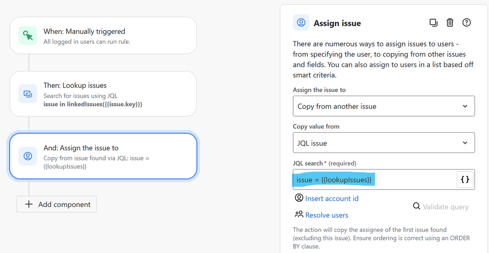

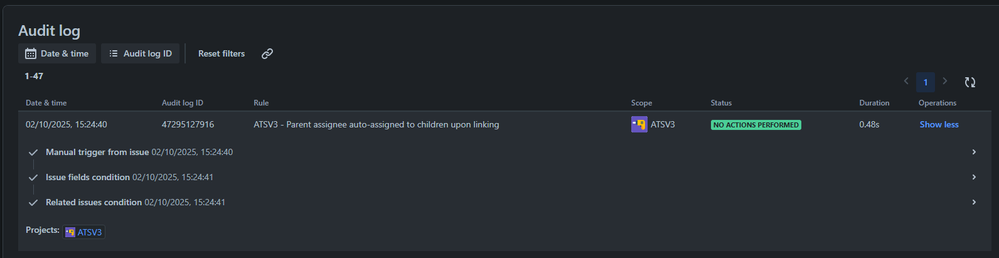

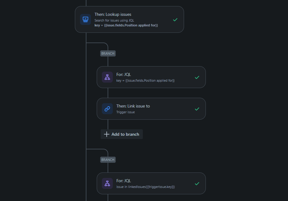

Hi @Calvin thanks so much, I've tried using the smart value {{issue.issuelinks.first.inwardIssue.assignee}} approach, exactly as you show it in the screenshot, unfortunately, even though the audit log says it ran successfully, the trigger issue still is unassigned.
Now I'm going to try your other recommendation: https://community.atlassian.com/t5/Automation-questions/How-to-copy-assignee-from-linked-issue-to-trigger-issue/qaq-p/1869878, which looked really promising although I think I already got stuck lol.

I had a go now, and instead of using "issueKey = {{lookupIssues}}" I used "issue = {{lookupIssues}}" and that looks to work on my system.
Aiste Marija Aidukaite-Urbanovic February 12, 2025
Hi @Calvin , I can't believe it! It worked! Thank you so so much!

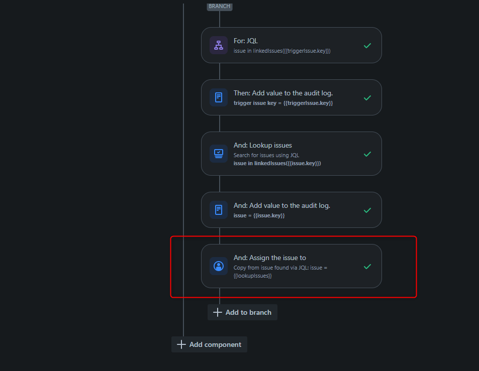

Aiste Marija Aidukaite-Urbanovic February 13, 2025 edited
Hi @Calvin!
Promise this is the last question on this thread. :))
My first rule, that links issues automatically, doesn't trigger the second rule that you helped me build, if I start the second rule with Issues linked trigger rather than Manually triggered from issue.
So I thought I will merge them both into one automation rule. It appears to be working quite well (I added Log action to see better), but the last step (And: Assign issue to: Copy from issue found via JQL) is erroring. I copied it exactly from the rule that we built together and which works perfectly when manually triggered. I'm not sure why this doesn't work now, do you have any ideas?
It looks like you've been busy :)
Short answer, try using the "Re-fetch issue data" value before the branch but after your automation makes the link, it looks like this:
Long answer - the components that are run inside the automation takes the details based on what it looks like "before the automation". So when your automation starts there is no link, even if you add the link after in the automation, everything after it doesn't know that because it only knows what it looks like at the start before the automation has run.
Running re-fetch will pull the updated data and hopefully then it should see there is a link there and assign off it.

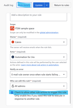

Just a heads up, automation rules don't trigger other automation rules unless you switch them on to do so under "Rule Details"
Cheers!
@Calvin I switched it on and now it works as two separate rules :) thank you so so much!
