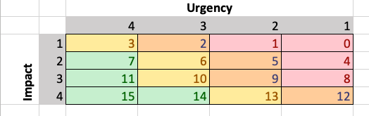

Below is the sample matrix of impact and urgency resulting in the priority.
The priority value is shown by colour, where red - priority is 1, orange - 2, yellow - 3, and green - 4.
It is possible you might have other priorities like 5, and 6 - but it does not matter, since the approach will work for any number of.
The numbers in the coloured cells are sequential and serve a purpose to "address" the priority value in the list of priorities which can be defined as a priority sequence:
1,1,2,3,1,2,3,4,1,2,3,4,2,3,4,4

To get the "address" of the priority we need to use the following formula:
(Impact+Urgency) + ((Impact-1) * (NumberOfColumns-1)) - 2
Where NumberOfColumns represents the number of Urgency values, in our case we have 4.
Quick test:
Impact = 3
Urgency = 2
priorityAddress = (3+2) + ((3-1) * (4-1)) - 2 = 5 + (2 * 3) - 2 = 9
9th address in the prioritySequence above is 2 (2 - High) - orange colour
sequence: 1 1 2 3 1 2 3 4 1 2 3 4 2 3 4 4
address : 0 1 2 3 4 5 6 7 8 9 10 11 12 13 14 15
