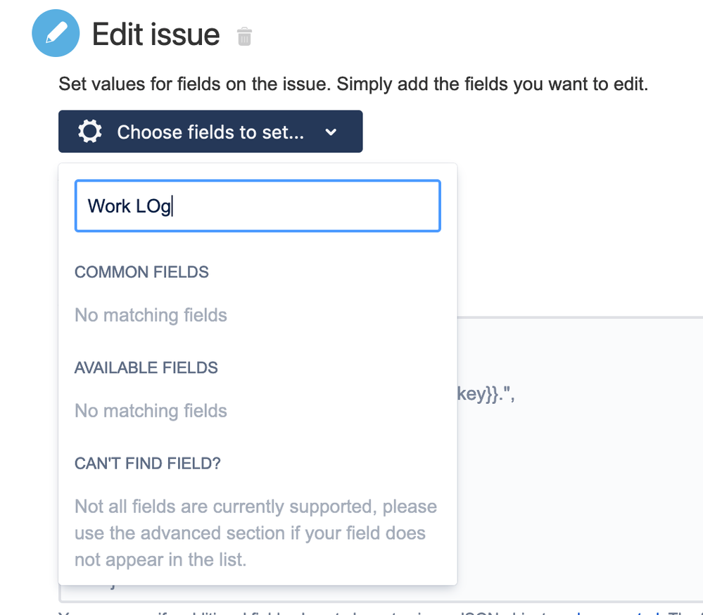

in a Server Jira Service Desk (JSM) project, I created a request form where I set a numeric custom field to put in the time (hours) the requestor worked on a task. I'm currently trying to fetch the value from the custom field and copy it to the "Time Spent" or "Work Log" system field with the "Automation for Jira" Add-On (Lite).
Basically the automation should go as follows:
When issue created > Edit Issue > Field to set: "Work Log" / "Time Spen" > Copy Value From "Custom_Field"
Actually, we're using Tempo for time tracking. But it seems like neither Tempo fields nor the default fields provided by Jira regarding time tracking can be shown in a service desk request form. Also the "Work Log" and "Time Spent" fields are not listed the "Edit Issue" rule paramaters in "Automation for Jira" (see attachement)
I'd prefer looking to get it running with Jira Automation but I'm open for other ideas / workarounds. If possible, I'd avoid a solution with Script Runner or other scripting.

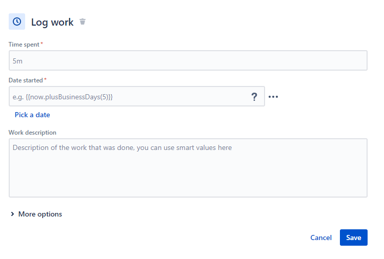

I´m not quite sure about the possibilities with Automation Lite but please check if there is an action that logs work (see screenshot - from cloud):

Hi @Stefan Salzl ,
I just installed the full version of "Automation for Jira" as a trial. I'll try to get it done with the "Log work" rule.
Do you know, whether I can copy the Time Spent from a custom field?
Unfortunately as it seems this is not possible:
But as mentioned before you could use the log work action and add the value from your custom field via smart value.
