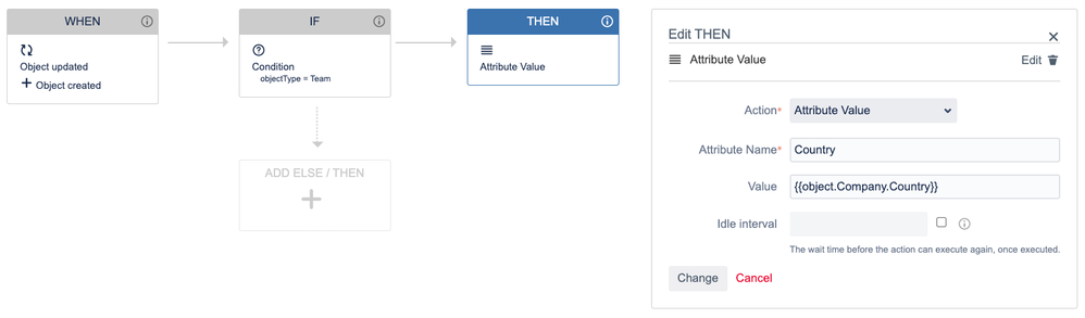

This is what my automation looks like?
Any more ideas?

Are you on Datacenter?
In Cloud: As mentoined above: I´ve setup an automation, which looks like yours and it works.
I´cant see the automation in the Assets/Scheme Configuration and have to setup the automation in the global Automation settings.
Nadine Schuett
August 29, 2025
Yes, unfortunately we are still on Data Center so I guess this is why your approach does not work ;-(
