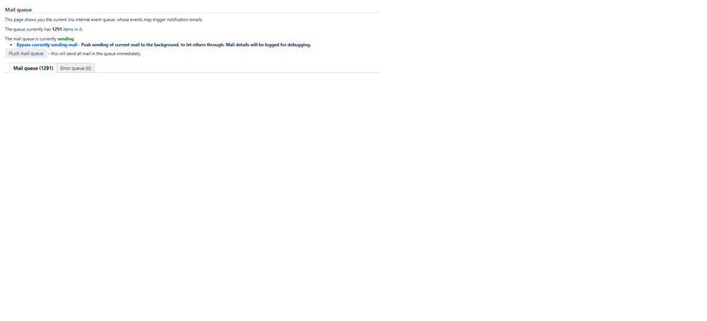

In Jira Data Center version 9.12.24, emails are stuck in the queue and are being sent one by one (as I see in the mail queue).
Before this, everything worked fine.
Maybe this information will help: yesterday we migrated the server from Hyper V to VMware  the server was copied exactly as is.
When I click Flush mail queue, nothing changes  the same emails remain in the queue.mail queue.png

Ifound the problem, when we migrated, we had 2 network cards and also installed them on the new server, but on the new server they conflicted with each other. After i disabled one, everything started working

first of all, due to server migration, please check that the outgoing server email is still working (try to send a test email). Based on your screenshot, all seems ok and email on queues seem to be in progress.
In my opinion is not an issue at application level.
Btw, please could you check the atlassian-jira-outgoing-mail.log under your <JIRA-HOME>/log folder (please check the current node if you have more than one node active).
