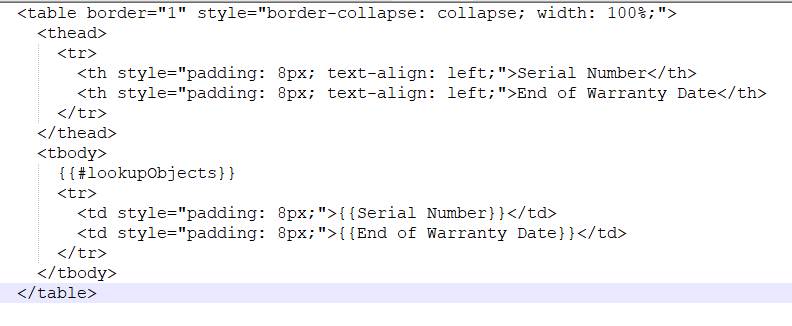

I used this (screenshot because I am struggling to NOT format it here):

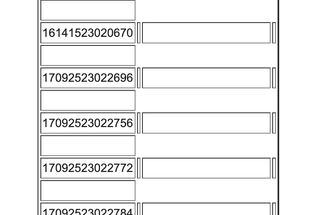

I am struggling to know where to put the lookupObjects and the result is not really pleasant visually in the email.
Does any of you know how toformat it correctly ?

I've struggled with this too so I usually use lists which are a little easier but I would try inserting the lookup smart value after <tbody> and before <tr> and see how that renders and have the headers outside of the <tbody> in a <thead> section

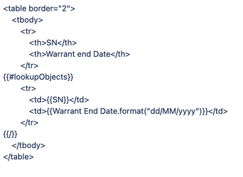

or you can give this a shot for a table
