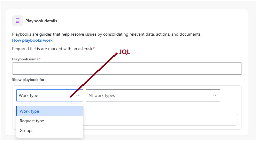

June 12, 2025
I think it would be nice to have more granularity in which we can add a playbook via JQL. We recently consolidated down from like 70 request types down into 15 for the sake of our users, so really it would be nice to have the ability to use JQL within the "Show playbook for:" of a new playbook to allow us to have more options on when to add certain playbooks.

Hey @Michael Bachmann
If you are unable to see the option, please feel free to reach out to support, link mentioned here and our team will be able to help you. Thanks!
